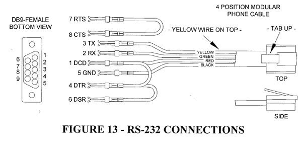

- Connected a 4 wire ‘phone cable” to the RJ-11 port on the Omni LT.
- Made an adapter with an RJ-11 on one end and DB-25 on the other end based on the wiring diagram in the OmniLT installation manual. (see attached). Note the RX and TX are crossed over. Tested with DMM and all connections are good.
