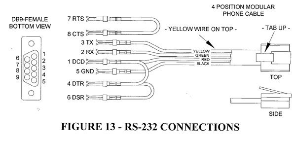

  4. Made an adapter with an RJ-11 on one end and DB-25 on the other end based on the wiring diagram in the OmniLT installation manual. (see attached). Note the RX and TX are crossed over. Tested with DMM and all connections are good.
Note: My OmniLT does not support the AES encrypted Omni-Link Protocol. Is that why these apps do not work? ChatGPT states if I can find an old HAI snaplink version 1.6 APK I can user that and it will work but I can't find it on the web.

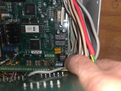

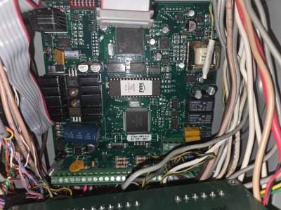

Please take a picture of your OmniLT board and post it.

My plan is to connect an ethernet cable to my router and use a Latronix UDS1100 listening in on Port 4369 with a static IP. Then the DB-25 on the UDS1100 connects with adaptors rossing over pins 2 and 3 to the RJ-11 port at the top left of the omniLT board. The HomeTroller Pi also connects by ethernet to the same router. After I set up the desktop version of HS4 and add the Omni plug-in, I can download the mobile version HomeSeer and when I log in it recognizes the plug-in. I will use the mobile version, it send commands to the cloud which then go to the HomeTrolller Pi. This then connects by TCP to Port 4369 to my HAI and executes the commands, and no AES encryption is used. So this should work with Omni LT V 2.14 Board photos attached. There is an expansion board on top of the LT board and a 2-way voicee module inside the eiclosure.

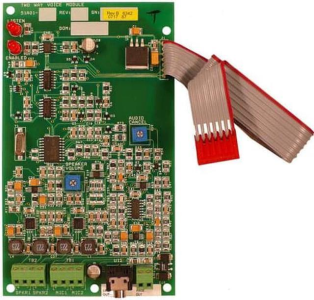

I bought an Omni LTe board for the ethernet connectivity but now I see that it does not include audio capabilities so except for the tone on the console, there is no sound in the house if the alarm is tripped. My Omni LT had a separate audio board connected to a speaker that can be heard throughout the house and also gave audio as to what type of alarm it is. Any suggestions?
Upvote 0
Good news @bobgto65 !!!!
By default there are chirps coming from the keyboard consoles. I think that you can connect the audio board from the OmniLT to the OmniLTe.
The OmniPro audio board gives you some speech.
Leviton Omni 2-Way Voice Module (10A11-1)
Here utilize the built in speech with Homeseer and or Home Assistant. I collect Microsoft SAPI voice fonts here and today utilize Google voice with Home Assistant.
