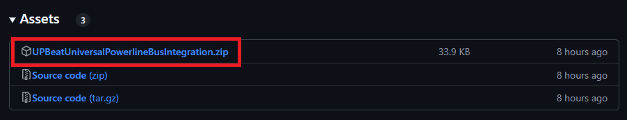

## Installing Hubitat Drivers

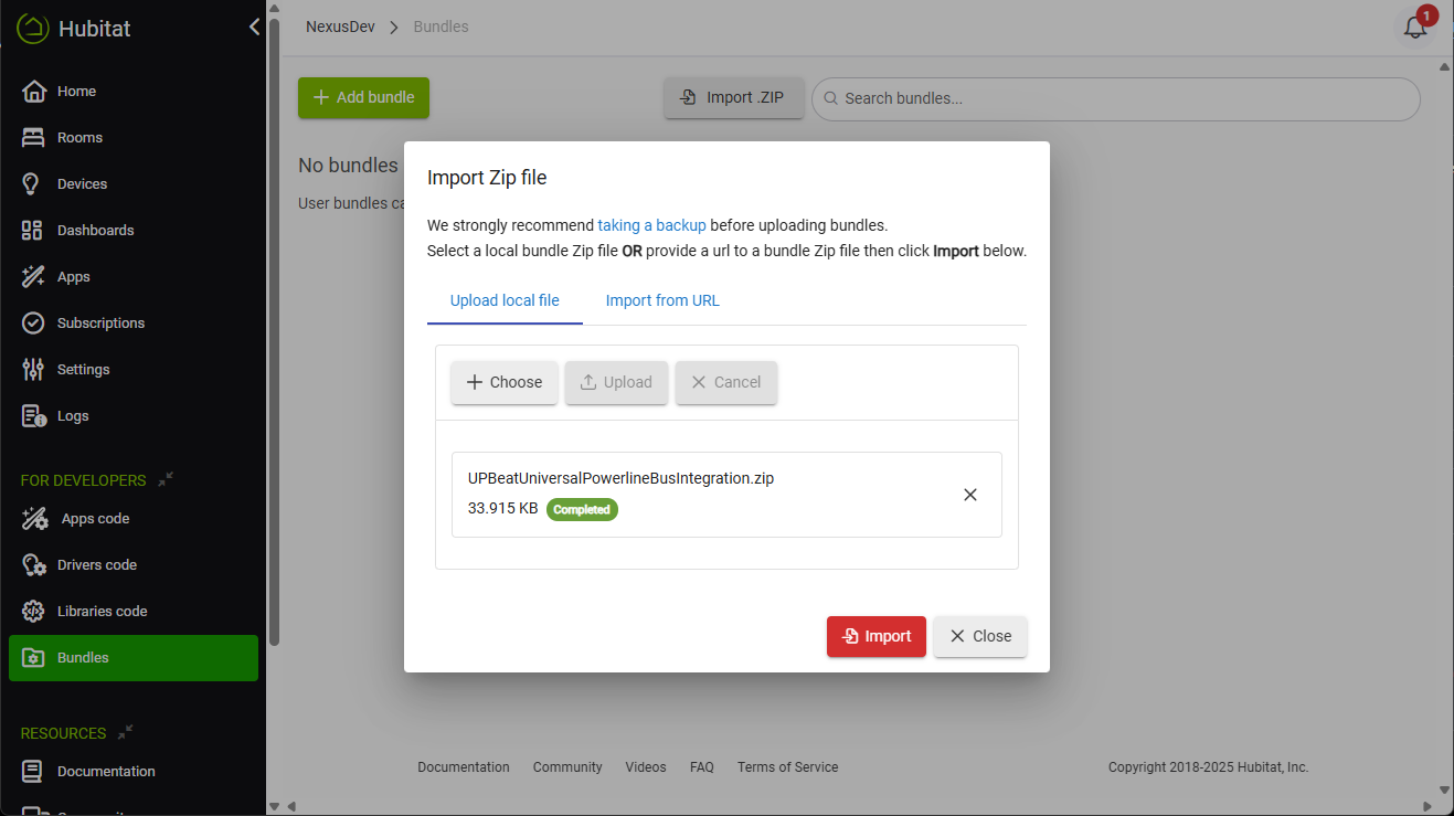

1. Download the drivers bundle from releases

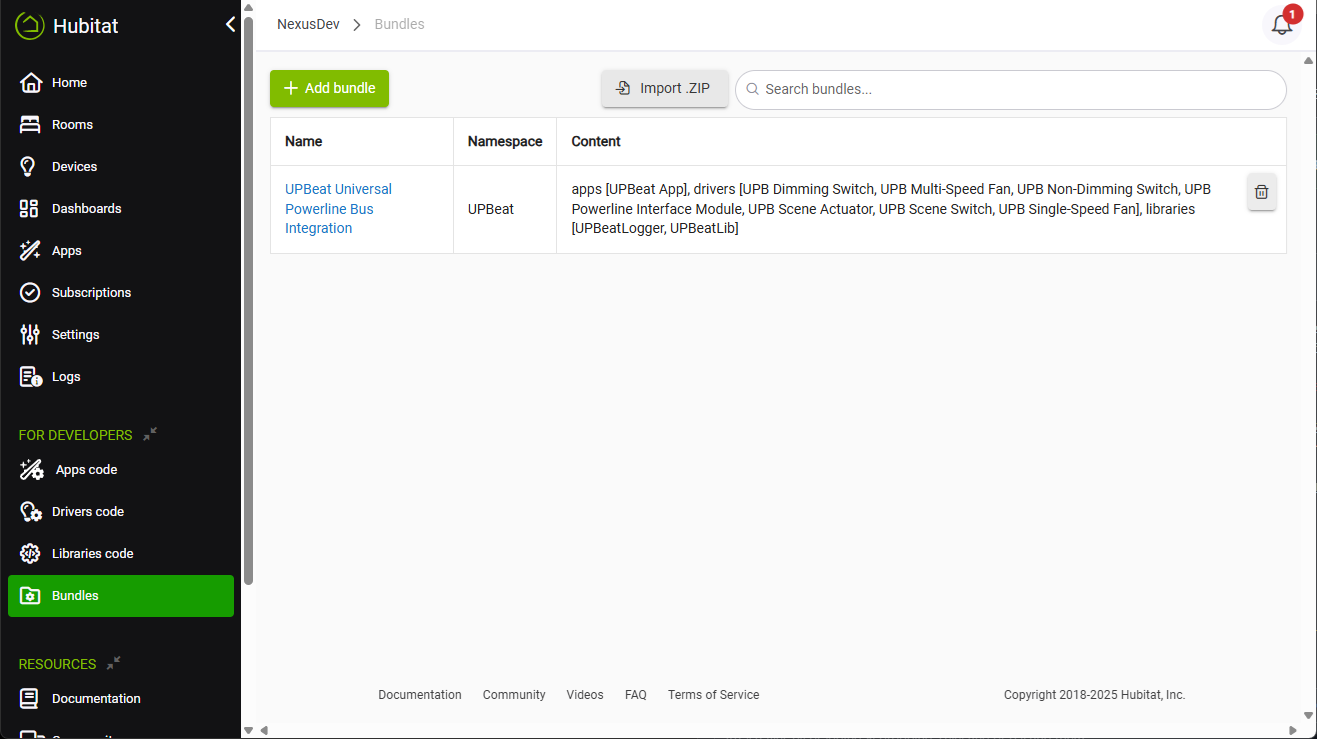

3. Navigate to your Hubitat Controller's web interface and go to the "FOR DEVELOPERS" --> Bundles
4. Import the "UPBeatUniversalPowerlineBusIntegration.zip" into your Hubitat controller.
5. Once the import is completed, you should see the following.

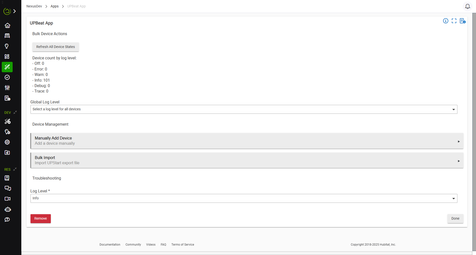

## Configuring the UPBeat App
1. Navigate to your Hubitat Controller's web interface and go to the Apps section.

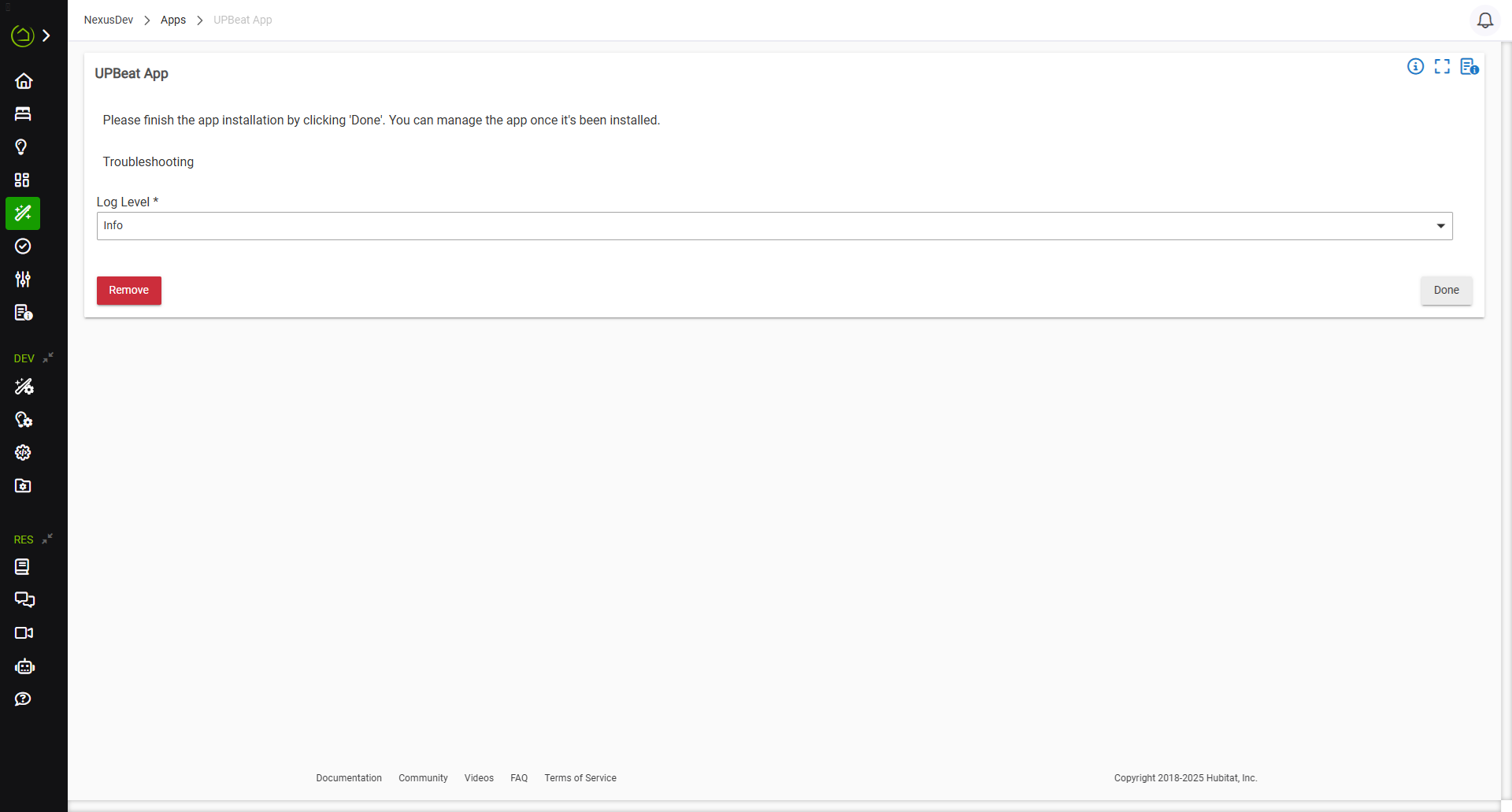

2. Click "Add user app" and click UPBeat App.
3. Click "Done" on the app page.

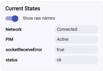

The PIM driver is a raw socket driver, sometimes you will see the following status.
It's completely normal and comes from the socket driver when no data arrives in a minute.

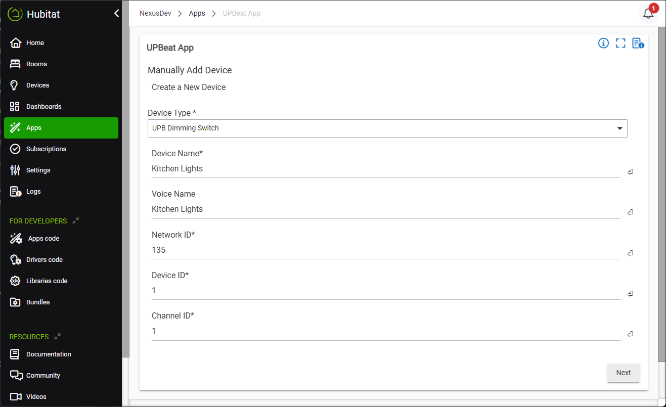

## Adding devices manually
1. Navigate to your Hubitat Controller's web interface and go to the Apps section. Click on UPBeat App.
3. Click on the "Manually Add Device", select a device type. as shown below.
4. Set the Name, Voice Name, UPB Network Id, and UPB Device Id, click Next.

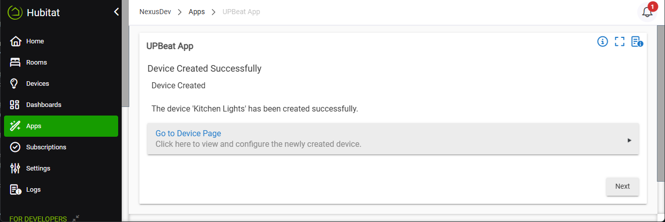

5. Click the Go to Device Page button.
6. You should now be able to control your device.

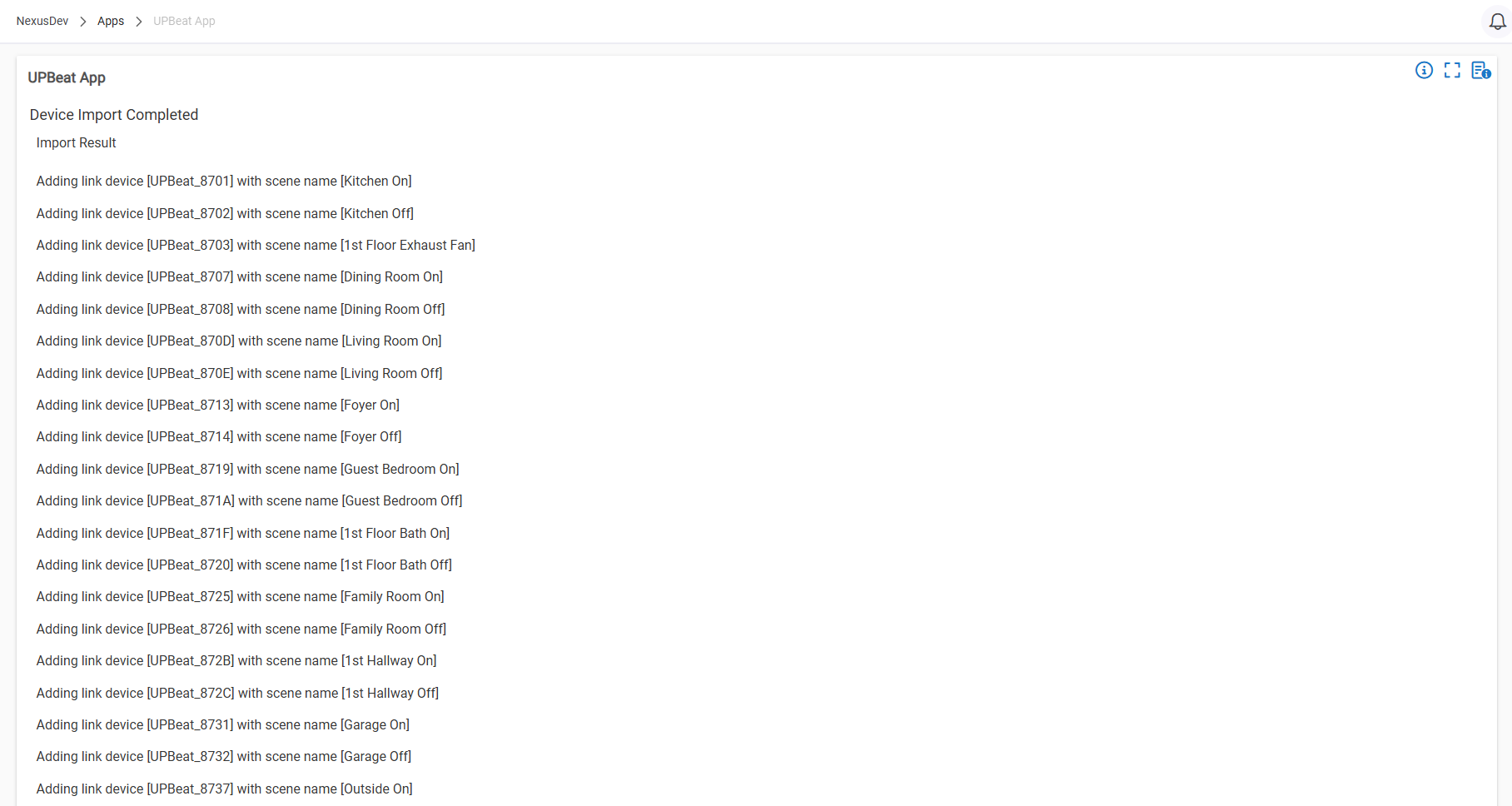

## Adding devices via UpStart UPE import
2. Select Bulk Import and paste UPE file contents. Then click Next.
Review the import results, and click Next.
You are ready to go...

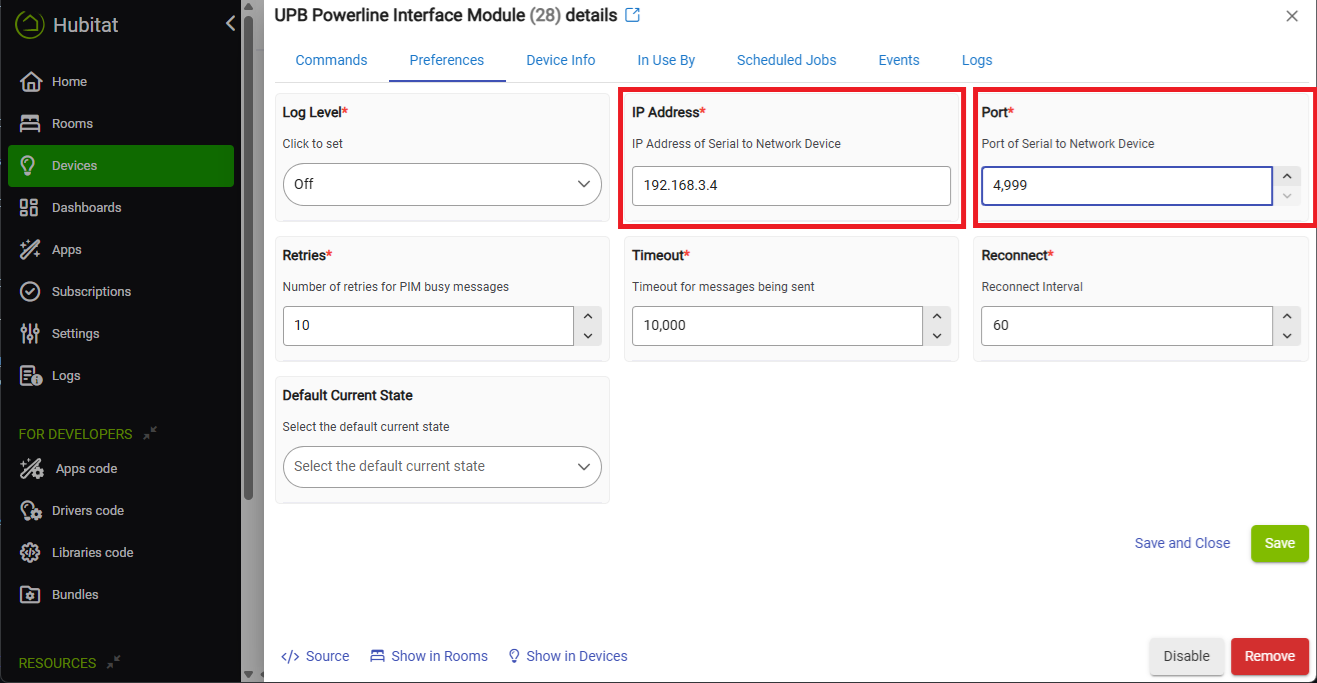

3. As root, using a text editor, modify the /etc/ser2net.yaml. The only entry that is needed in the full file is shown below.
#### Raspberry Pi example with Pulseworx PIM-U Powerline Interface Module:
YAML:
%YAML 1.1
# This is a ser2net configuration file, tailored to be rather
# simple.
# Find detailed documentation in ser2net.yaml(5)
# A fully featured configuration file is in
# /usr/share/doc/ser2net/examples/ser2net.yaml.gz
# If you find your configuration more useful than this very simple
# one, please submit it as a bugreport
connection: &UPBPIM
accepter: tcp,4999
enable: on
options:
kickolduser: true
telnet-brk-on-sync: false
connector: serialdev,
/dev/ttyUSB0,
4800n81,local
4. Once you have saved the changes to the /etc/ser2net.yaml file you will need to restart the ser2net service. Using the following commands.
Code:
sudo service ser2net stop
sudo service ser2net start

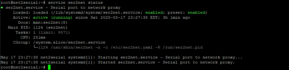

5. Check the service status using
sudo service ser2net status you should see somthing like shown below.## Installing Hubitat Drivers

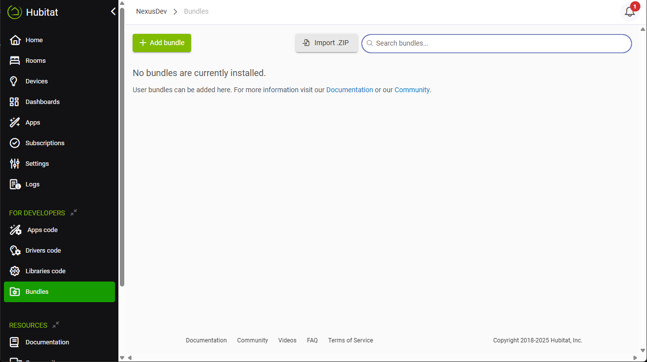

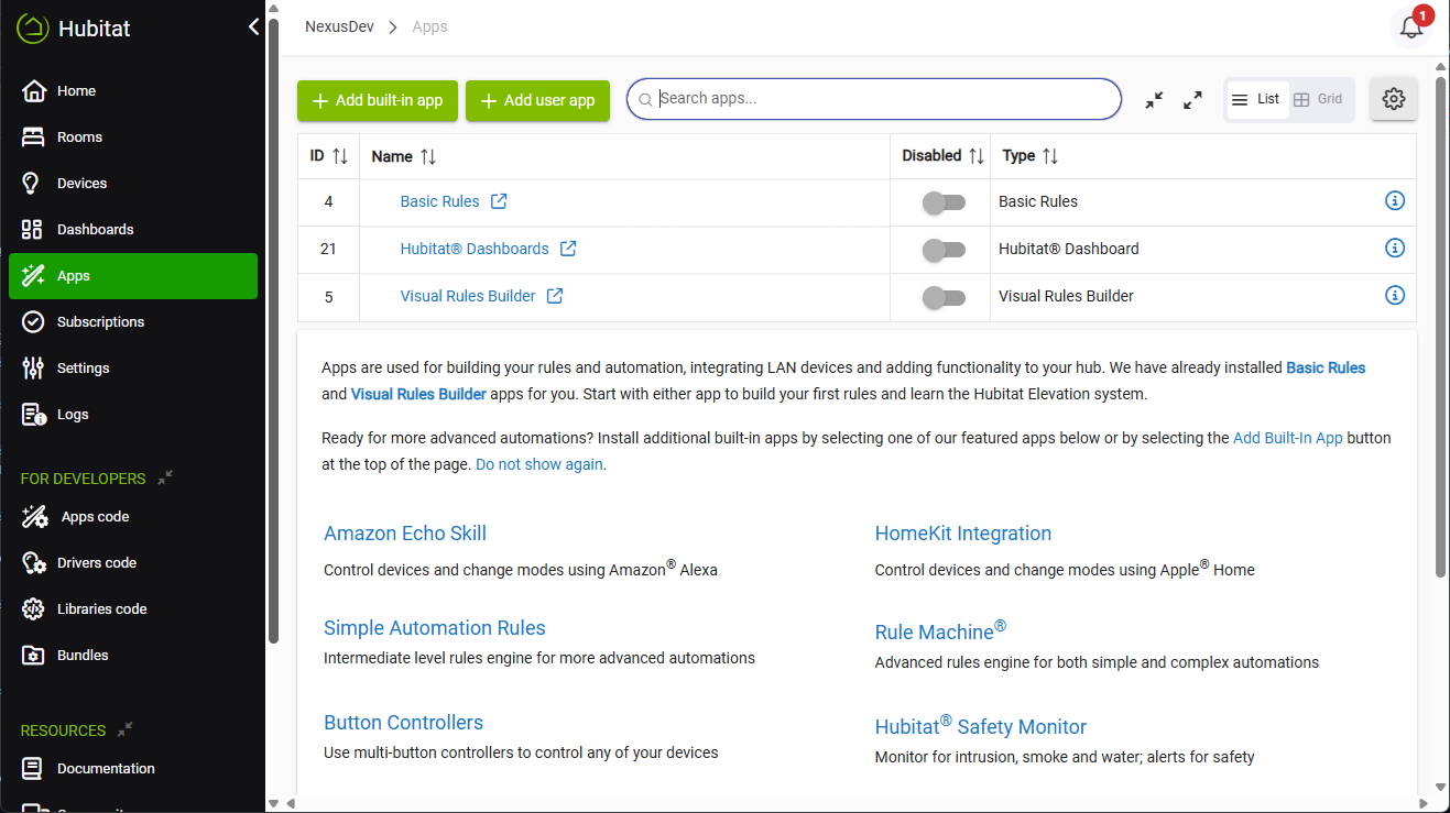

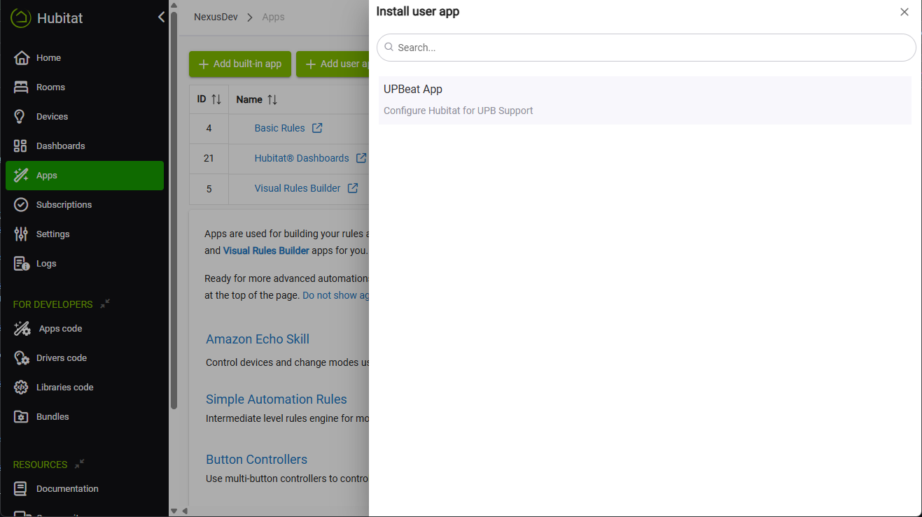

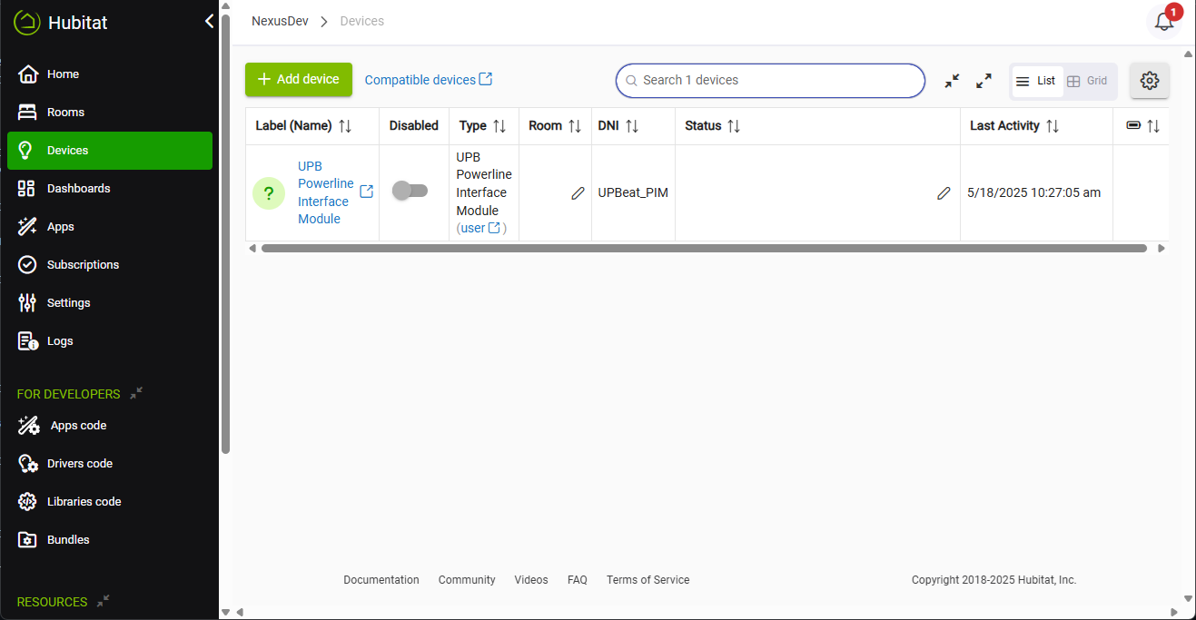

## Configuring the UPBeat Powerline Interface Module
1. Navigate to your Hubitat Controller's web interface and go to the Devices section.
3. Edit the UPB Powerline Interface Module device, goto the Preferences tab. Set the IP and port of your ser2net device from earlier.

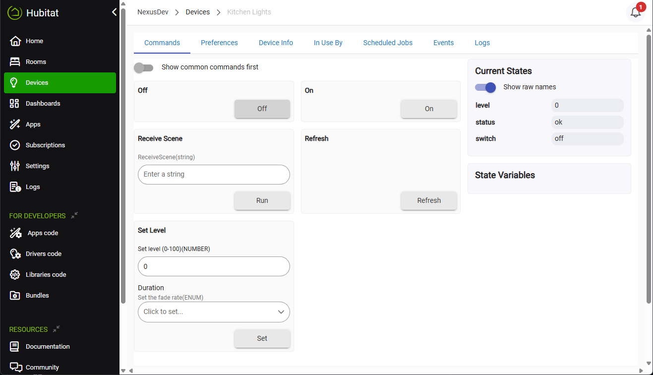

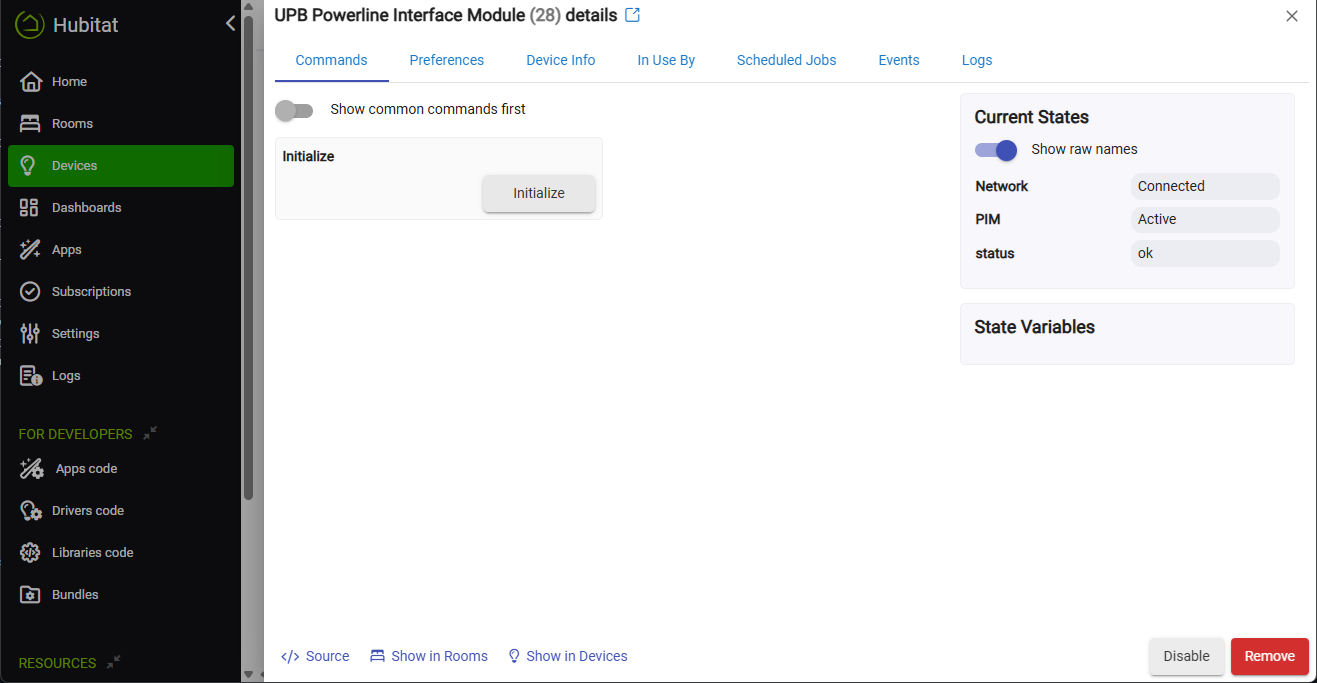

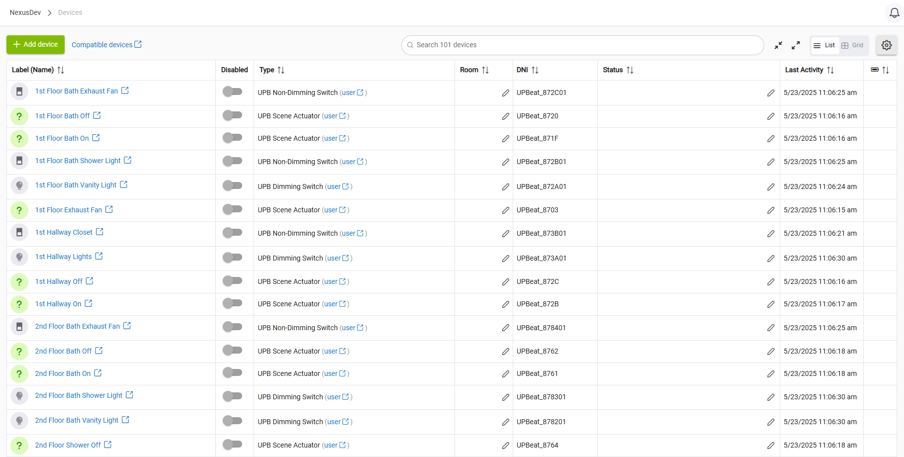

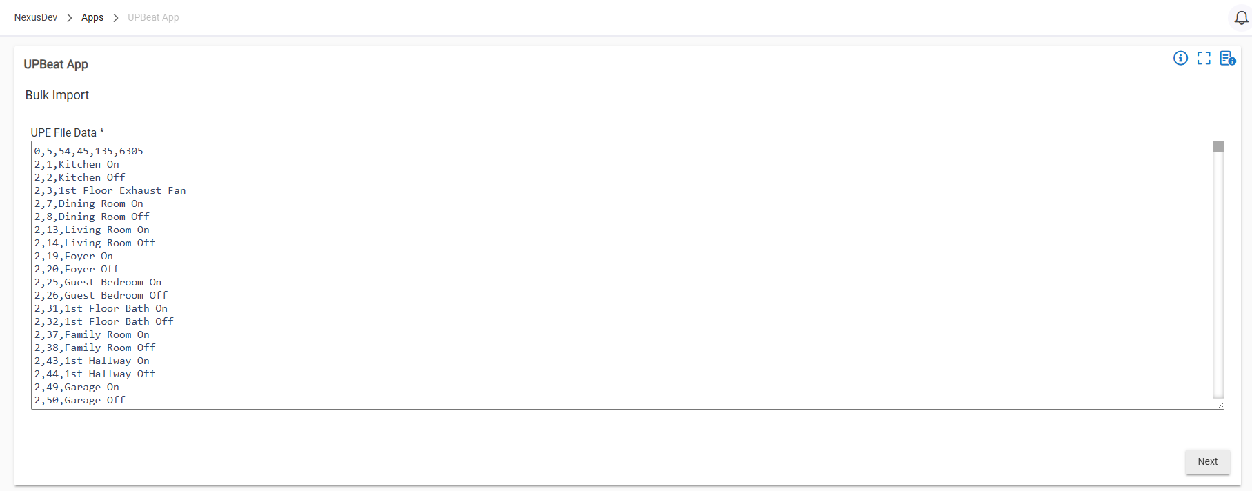

5. Save, the setting and go to the Commands tab. You should see the following.
