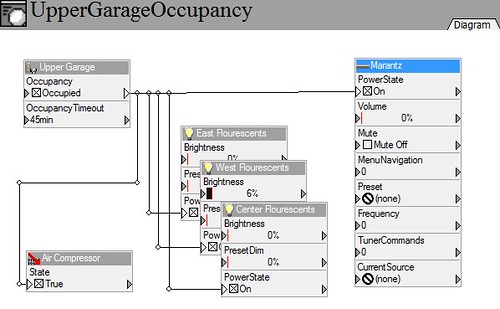

After testing that it actually worked I then changed this logic diagram:
Just damn cool how easy this stuff is.
