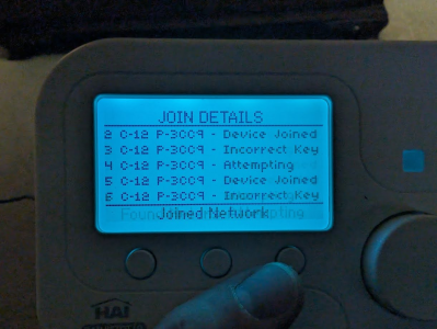

So I cant seem to get any of the three Omnistat RC2000s to pair with my OmniPro II via a Leviton ZIM. The ZIM has the firmware and radio both updated to 15.07 ( I believe this was the last release by Leviton). I have three locks and a light all working fine with the panel, all enrolled using PC access.
When I try to pair the thermostats, I disband them in the install menu, then click enroll. I then have tried pressing enroll both in Dealer Access and directly on the ZIM. In all cases, the T-Stat immediately reports:
Device Joined
Incorrect Key
Attempting
And this repeats over and over. Any thoughts?
