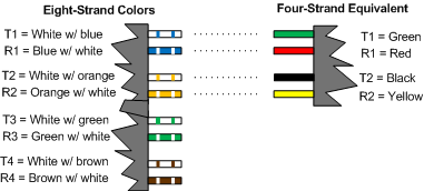

My doorbell cable - 2 pair, twisted, green and yellow pair, red and black pair - runs from my doorbell to the kitchen intercom master location.
Intercom was removed. I'm extending the 4-conductor doorbell cable to the basement mechanical room, for future use.
I have a category cable run from this intercom location to the basement, ran it a few years ago.
I am doubling up the pairs on the category cable, and using it to extend the 4-conductor. Is there a color coding convention for splicing?
Orange strip/orange to red? Brown stripe/brown to black?
