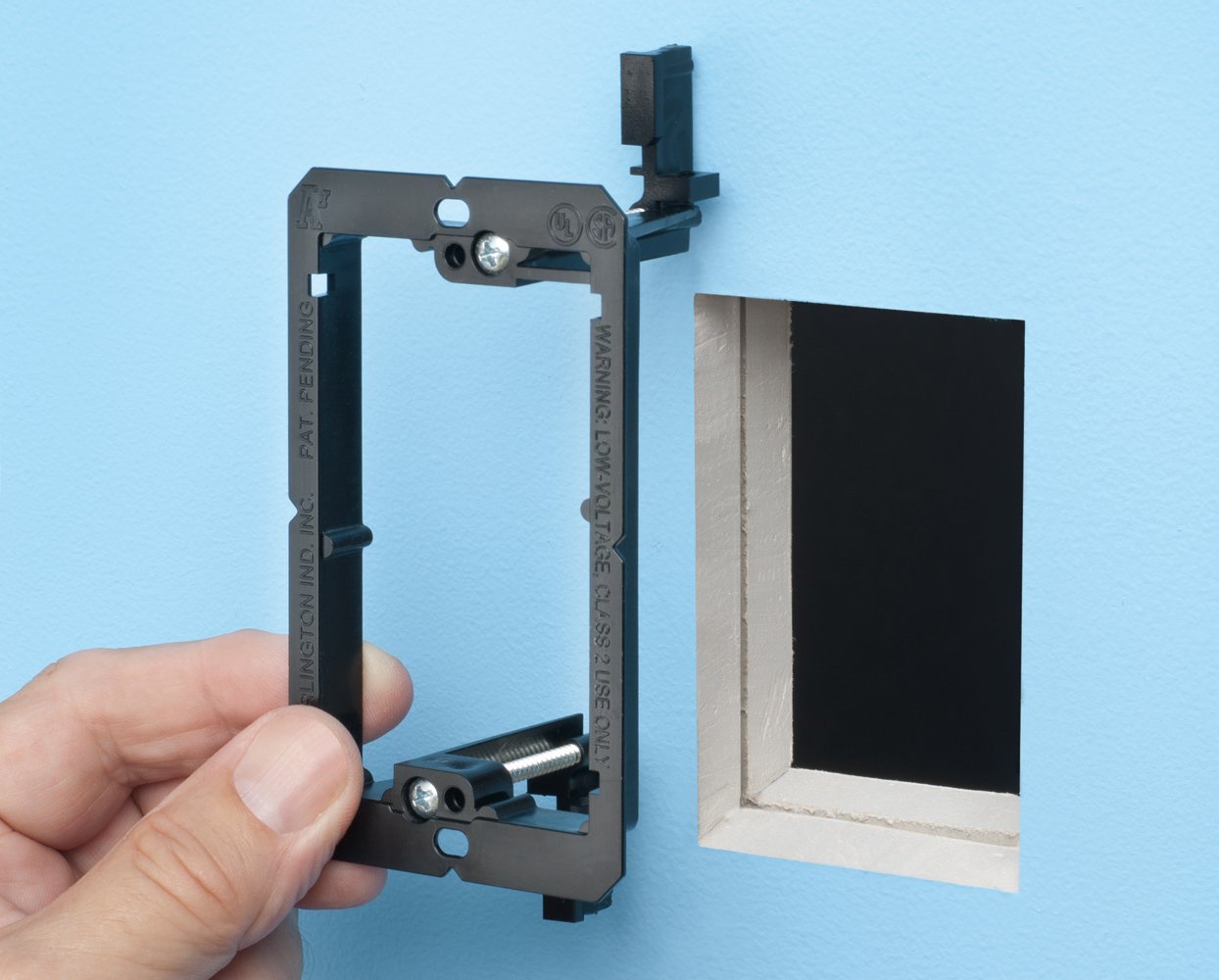

1) Nail a plate to the stud and pull a wire down to it.   Let sheetrockers cut the hole.
2) Leave the wires attached to the stud.  Measure/record where it is.   Cut the hole after the sheetrockers are done and install a post LV plate.

#1
#2

I like the new work boxes/plates better as they are more stable, slightly bigger (NuVo keypads don't really fit in old work wall plates), and easier to keep parallel.

I use them as designed, #1 if new construction (or if existing walls but replacing drywall) and  #2 if remodel work where I'm adding into existing drywalled locations.  .  I've had a variety of new construction work done on my house and used #1 for all of that.  I also re-did drywall on a couple walls in a room (termite damage) so I used #1.   Everywhere else it's obviously #2.
Given this sounds like a new build,  the LV will be stapled to the studs no matter if you use #1 or #2 (required by NEC).  Only if you ran it after the fact (fished through closed wall cavities) would you get away without staples.     You could pull the staples after the rough electrical inspection is completed, if you don't want to deal with all your LV stuck to studs.
I've used the ones shown in #1 multiple times with new construction and haven't run into any issues. Just be sure that the wires aren't close to the front of the box and you should be fine.
I typically use the ones from Carlon which create more of a "box" and have holes for conduit to be mounted to - or for your wires to pass through. Typically, I either simply pass wiring through them and let the excess hang lower in the stud cavity (so none is IN the "box" to be damaged) or coil it up such that the loops are large enough that they can fit into both the upper and lower holes, basically as a place-holder for the wire.
You need to pay attention to what is intended on being mounted to them....many times the rings stick proud of the surface or create other issues. You also need to keep them square and pay attention to the mounting. Also, not everything is best off being mounted to rings. SOmetimes they're overused.

DEL brought up the main thing I wanted to point out... the boxes for #2 are definitely not as flush to the wall and depending on what you put in there, it's quite easy to end up with a gap between your wallplate and the box.  That's actually a frustration I have quite often with that style... although I've definitely used plenty because I do a lot of retrofit work.  And I agree with his comment that boxes are over-used... I'm surprised actually how many times we see people use boxes for something that'll never cover that hole properly.
The rotozip is barely deeper than the drywall.  Follow the lead of the electricians - they work around the drywallers every time.  I liked drvnbysound's advice too to either pass the wire entirely through the box or create the loop using the holes top and bottom.
Yup none of the plastic rings that I have installed in Midwest after construction are totally flush.  I have had to use deep covers on them.  I did also trim the inside of the wall plate to make them flush.
