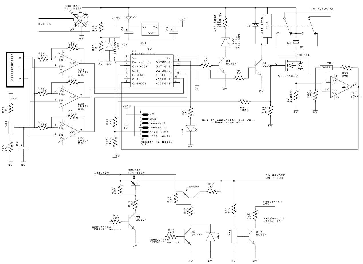

I'm building exactly such a system now!
Bi-directional communications with low-data-rate bit-bashing over a single pair (including power to run a motor)

I've got the concept sorted out in my head but waiting on my PCBs to arrive before I start coding. My plan is to bit-bash a low speed (1-2 bits per second) signal out. Each device downstream will have its own address, I can send commands to one device, or a broadcast address for all devices.
Like I say, haven't built it yet, but not anticipating any major problems. (Obviously, this is doing a lot more than "merely" communicating status)

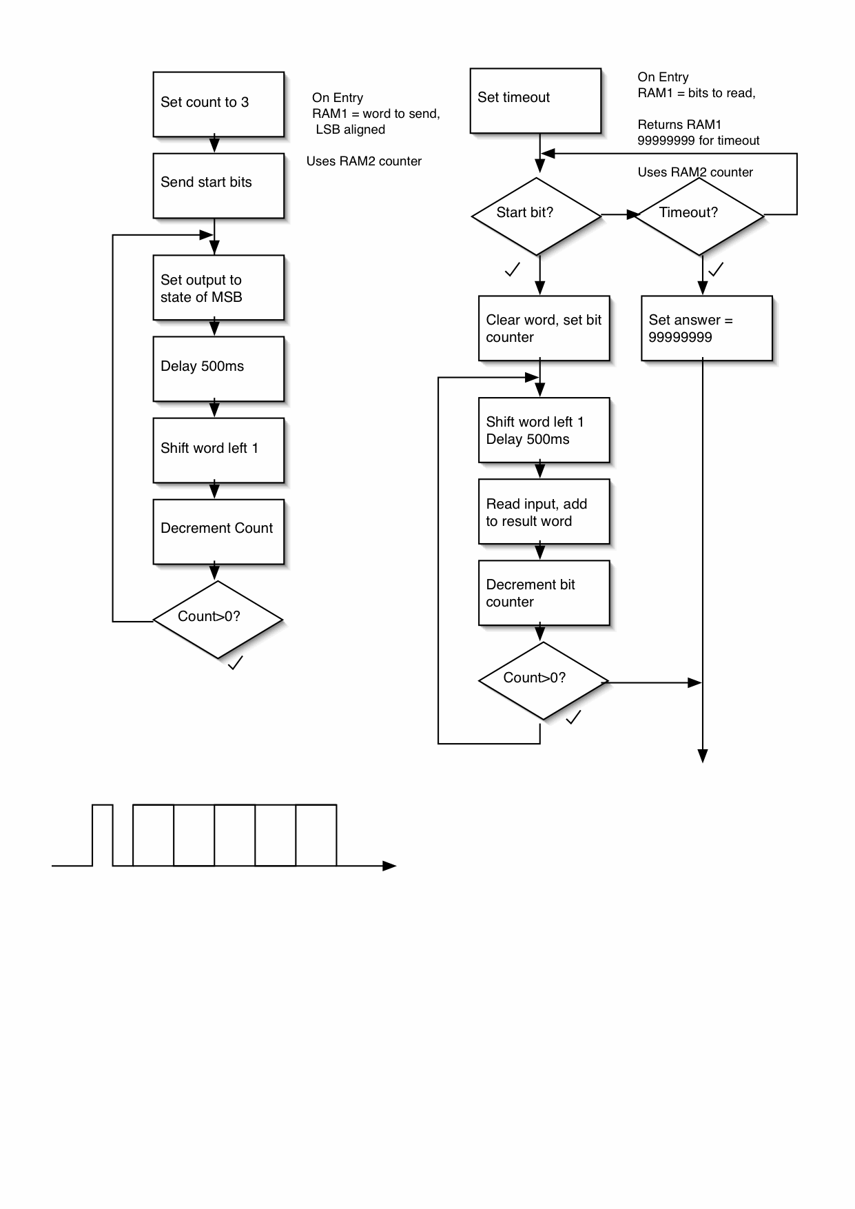

Here's a really rough flowchart that may help you get your logic straight in your head :)
