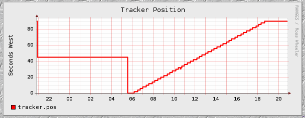

Here's a couple of traces from today. They're pretty grotty, but it'll have to do, I've been busy with other work.
The webcontrol board that records the array current is the same one that does all the tracker control. Here is its view of the tracker position during the day:

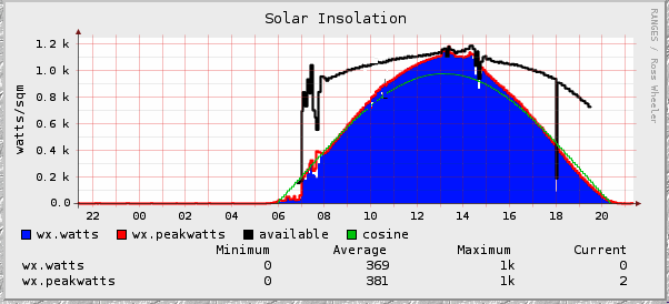

You can see for the first 90 mins or so after sunup at this time of year, the "midwest" tracker is in shaddow and its output is far below what it should be. I'll try to grab a picture of the output from the pyranometer for the same time.
Forgot to add the pyranometer output.....

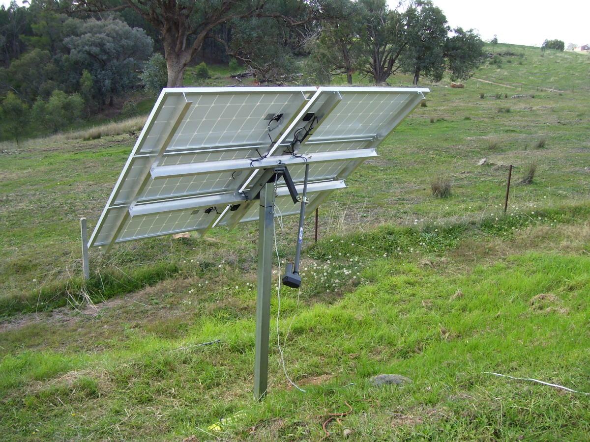

And for the curious... here is one of my trackers, showing the "working parts"
Ross,
You got more than 12 hours generation in summer there, that is really good. Don't know if your tracker also track the sun elevation, which changes a lot between 6/23 and 12/23.
