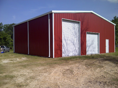

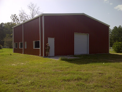

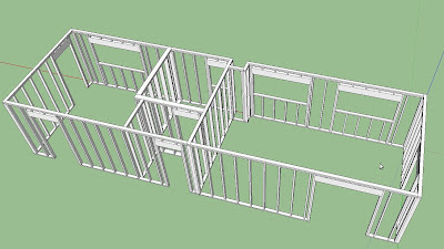

  • Metal Garage Building (40x44x16), three bays, one bay is framed in for workshop, restroom & kitchen ( I wanted to post picture but I am not allowed)
  • Rural area, dirt road, off normal path
  • Openings: 3 Roll Up Doors, 2 Man Doors, 4 Windows
  • Available: Power, Water
  • Connection: HS Internet available in the future - its a matter of ordering it, don't like to get phone land line if I can avoid this, good cell phone reception
  • 3 Neighbors in shouting distance (~400 ft)

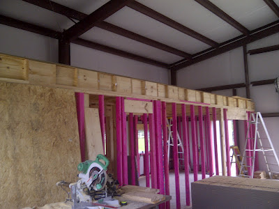

[background=rgb(231, 234, 239)]I am done with the inside framing and I am currently running all electrical lines and have good access to everything. So a wired system is 'ok'. Two neighbors are always around and one of them has a key to the building. So I think a security system that is "loud, deterrent and possibly scary" along with an option to notify me would be OK. A perimeter surveillance around the building would be nice too. [/background]
