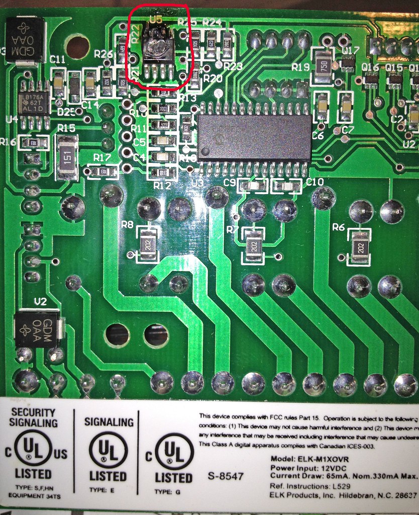

Upon closer inspection of the dead board, I found a burnt integrated circuit chip labeled "U5" on the back side towards the upper left of the board, and directly on the flip side of what looks like two resisters labeled "D24" and "D23". The board is mounted on those plastic pushpins, so it is isolated from the can enclosure- ruling out shorting to the enclosure.
Here's a photo:
Now, does anyone know why something like this happened??
Anything is possible. Any storms in your area recently? D24 and D23 are most likely diodes. I would think something power related would have caused it but once again this is just speculation. Do you happen to know the U5 markings on the chip on the new board? If the solder pads on the board aren't damaged it might be repairable. I don't know how much I would trust it though.

Like gatchel asked, what are the markings of the U5 chip (from the good board)? Knowing this, we could likely figure out the function of the chip, which in turn, may point you into the source of the problem. e.g. data bus, relay driver, etc.

I pulled the new board out again to look for the marking on that chip: LM393 PFRF
