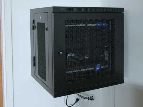

Small rack on casters, as 1 option.
Neuro, you stalker - that's the exact rack I use! A trip-lite 12U. Basically in one stud cavity, I have the 20" can that came with the house; above it I installed another 50" Channel Vision can with the plexi cover. I could've made that work, but residential can terminations and switches are pretty costly; and I also run an HP MediaSmart WHS, DirecTV with all of its components, and an 18-port switch and a full 19" wide firewall... so to the left of those cans I had just enough room to mount the 12U enclosure above my safe and make it all look nice. I moved the CatX and RGx to the wall-mount since that's where most of the connections to the switch would happen.

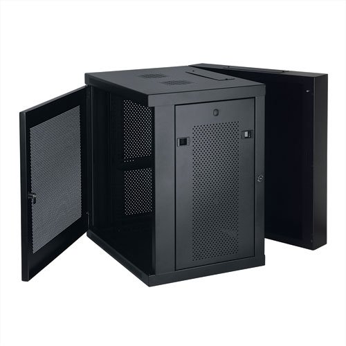

I initially purchased the hinge wall rack mentioned above for home installation in Florida. About 2 years after I installed it; removed it and put in a Leviton can.
I still have it and decided to "install" it in the attic of the house a few weeks back.
