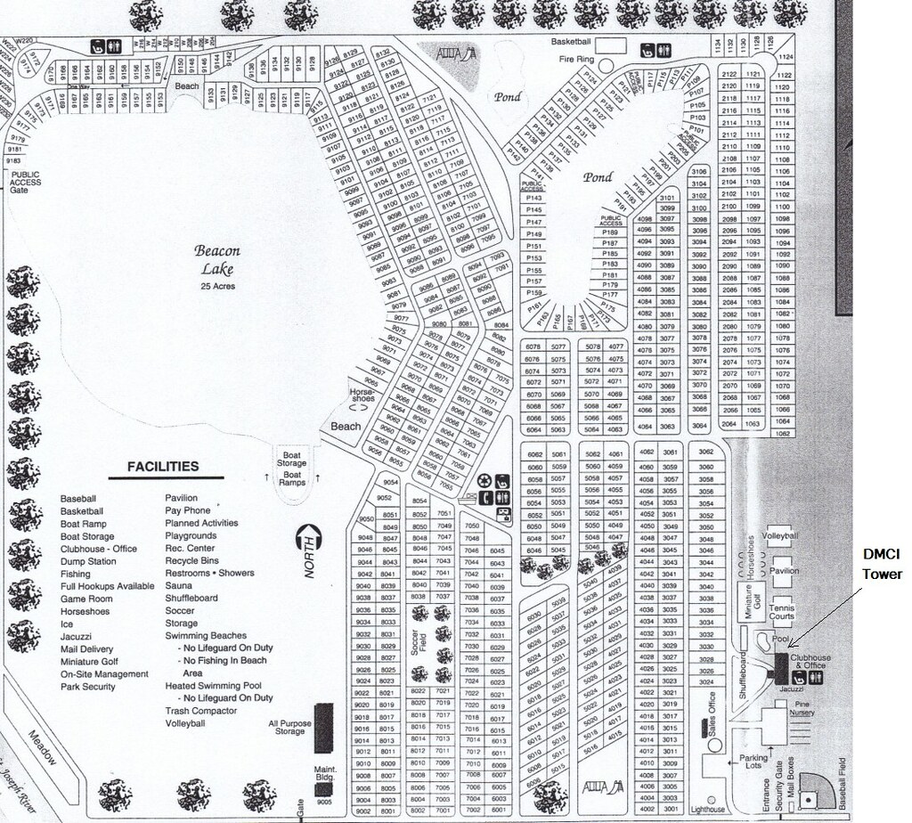

I would like to find a better WIFI solution to recommend for the RV park I am in. Below is the site map for the park. There is a DCMI tower located near the club house but no chance of any other cables running to any location in the park. Right now they use a Linksys Mesh Repeater arrangement that down right sucks. The repeaters/AP's need to be stronger so there are fewer of them to minimize speed loss getting to the other side of the park. Also remember that most people are using laptops inside metal trailers. Any ideas would be appreciated.
I know there are guys that know networks better than myself here. Hoping to find an economical solution that will improve reliability and performance.
Thanks
