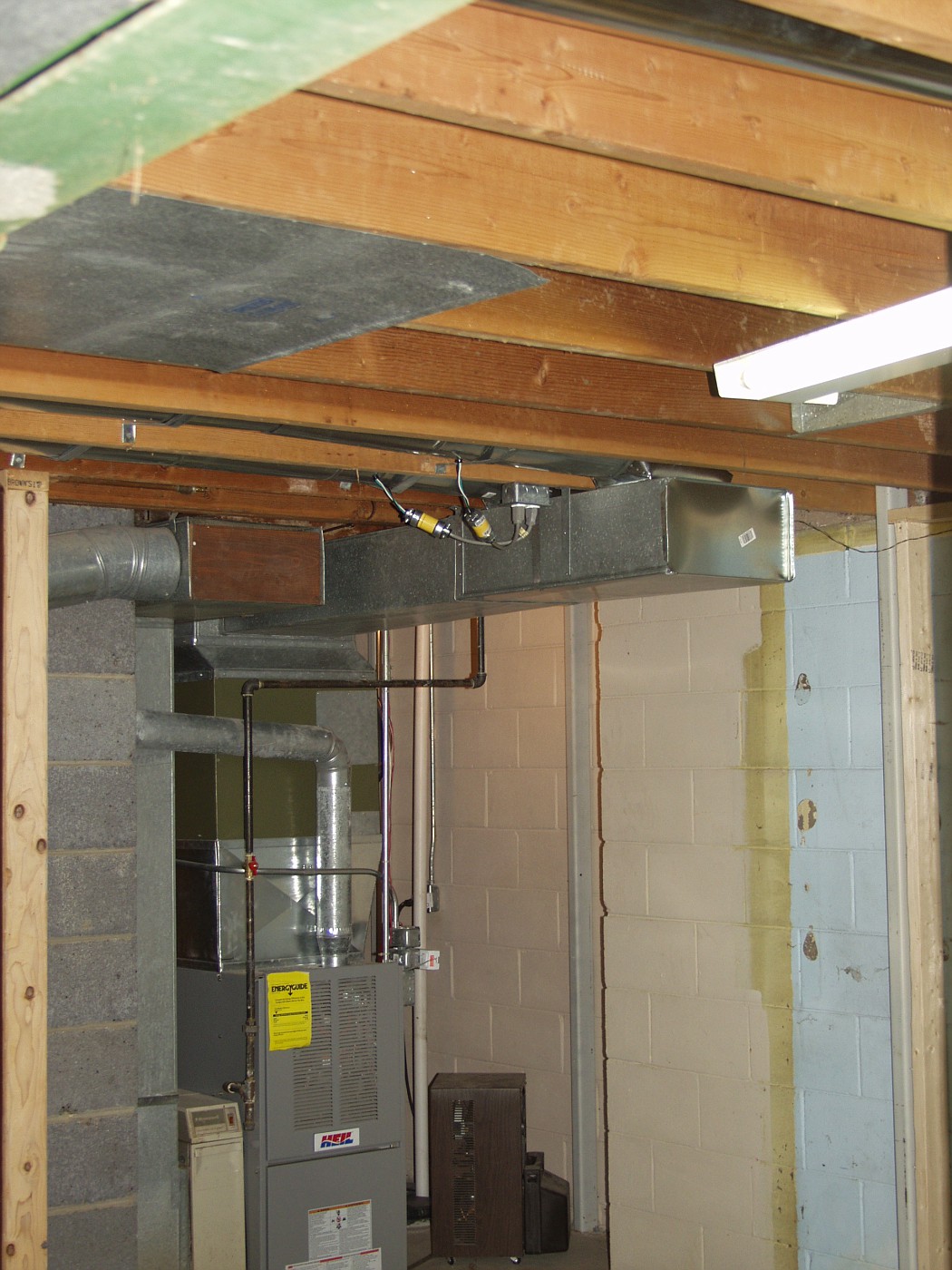

Fortress features a "split plenum" HVAC design that separates the main living area from the sleeping area. Inline duct fans that seperate the two plenums increase airflow to the living areas during the day and the sleeping areas at night. Here's some shots showing this:
Shot of the plenum going into the furnace
Shot of the split portion feeding the main living area
Shot of the two 8" ducts connecting the plenums with duct fans

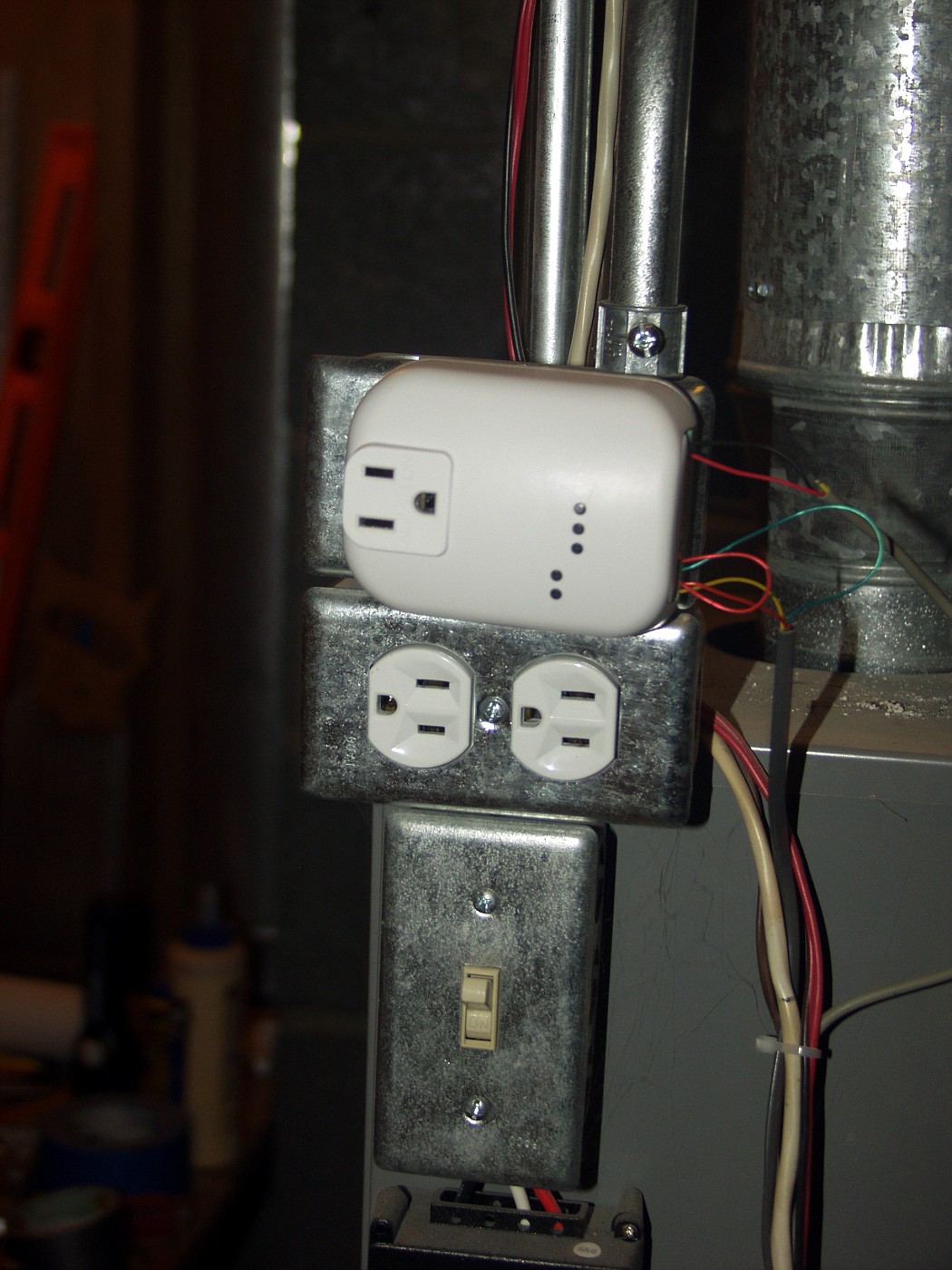

Shot of the UPB module that senses when the blower is running as well as whether the AC or the Furnace is active. HCA sets the global variables "AC Mode" and "Heating Mode" based on a sample that occurs when the blower motor activates. HCA makes the decision to turn on the ductfans based on the value of "House Sleeping". When Fortress is in AC mode, HCA ramps up the duct fans over time as the AC continues to run increasing cooling during hot days.
Hopefully the pics show how the system works. Essentially, the two 8" ducts normally restrict airflow to the main living areas, increasing airflow to the sleeping areas. When the fans kick in, the main living area duct is pressurized which increases airflow there and restricts airflow to the sleeping area.

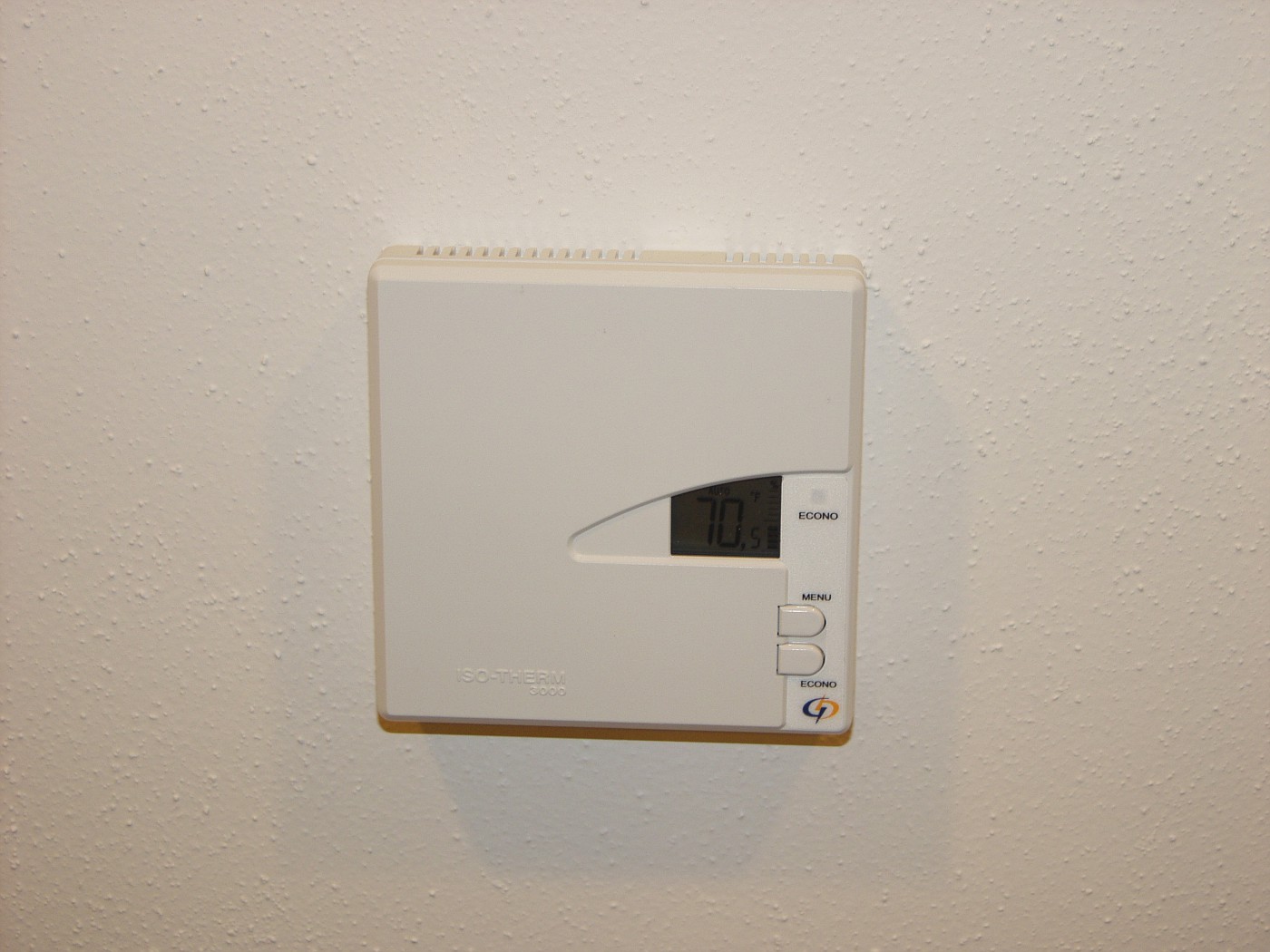

Shot of an ISO-THERM X10 thermostat

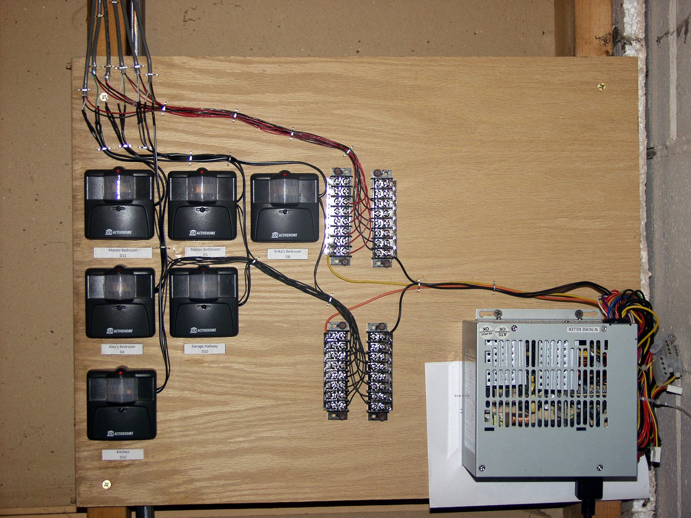

I chose this design combination because of a need for speed. Essentially, a W800RF32 can send large amounts of sensor data to HCA over a USB connection and wireless X10 commands have sub-second transmission times. Therefore, with the modified Hawkeye/Ademco combination, Fortress Control can receive several triggers per second when a room is occupied. This is key too since having highly sensitive motion detectors allows me to program fast light off timeouts while still retaining high WAF (lights don't turn off when a room is occupied). How fast is this? Fortress generally turns off room lighting 2 minutes after the last motion is detected even in the bathrooms. Light on times are noticeably better as well because a stream of events occurs when somebody enters a room.
Here's a shot of the Hawkeye Panel in the Basement:
yup, that's a modified ATX Powersupply supplying 3.3v to the Hawkeye sensors and 12v to the Ademco sensors
Here's a shot of a bedroom sensor:

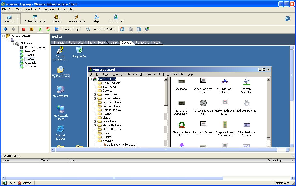

I'm running HCA v8.0 which also includes a web interface. It's Pocket IE aware too so I have access to Fortress Control from anywhere in the world! Here's a shot of the web interface rendered on PIE:
Here's HCA itself running as a guest OS within VMWare:

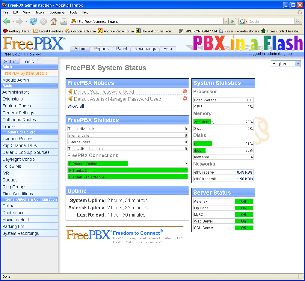

The Fortress phone system is VoIP based and I use Asterisk based PBX in a Flash as my primary PBX. It is trunked into my Vonage Softphone account and also runs as a VM on VMware. Based on CentOS 5, this totally free PBX system is just about the coolest piece of software on the planet. Setup is fully automated and it can even be run as a VMware appliance for those who don't have a dedicated PC handy. It has full AVR and conference capabilities, call minute tracking by extension, DID based call routing (for sending the In-laws to AVR hell during dinnertime) and even queue processing if I need it. Read all about PBX in a Flash here. Fortress features WiFi VoIP phones scattered throughout the house and the existing wired RJ11 ports are connected to our Vonage Primary account number for non-business use. My AT&T tilt also has Internet Calling enabled through Sleuth255's excellent WM6.1 ROM over at xda-developers.com. It becomes extension 503 when connected to the Fortress PBX over 3G.
Here's a screenshot of the System Status page:

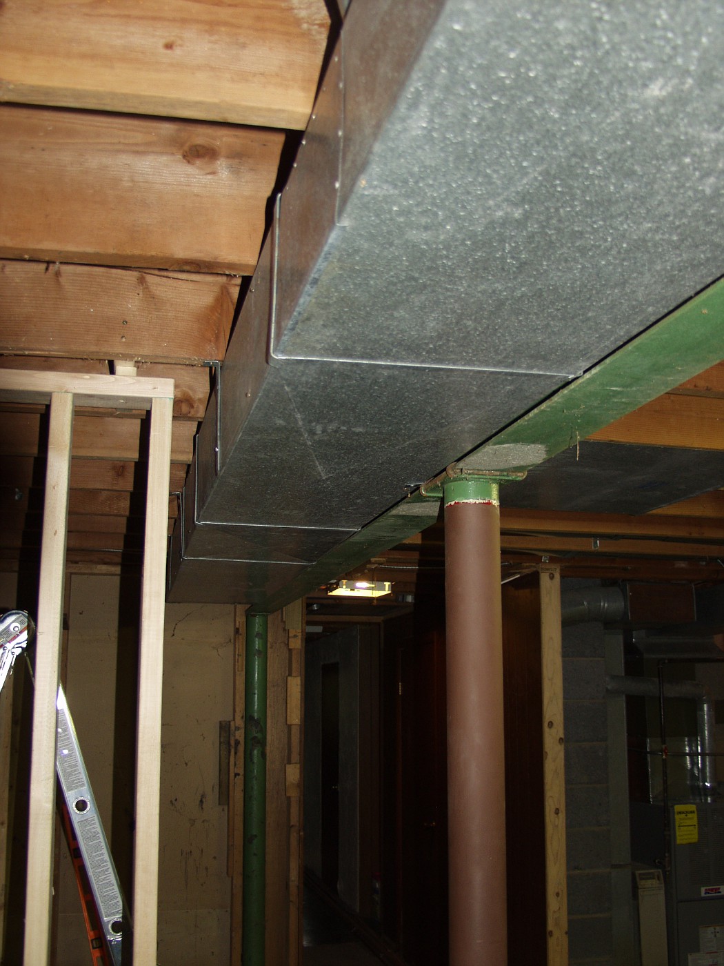

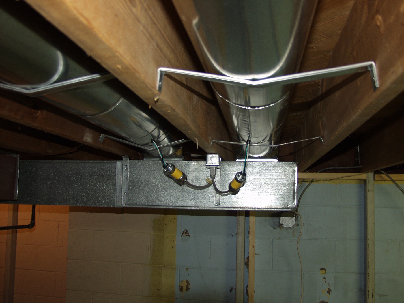

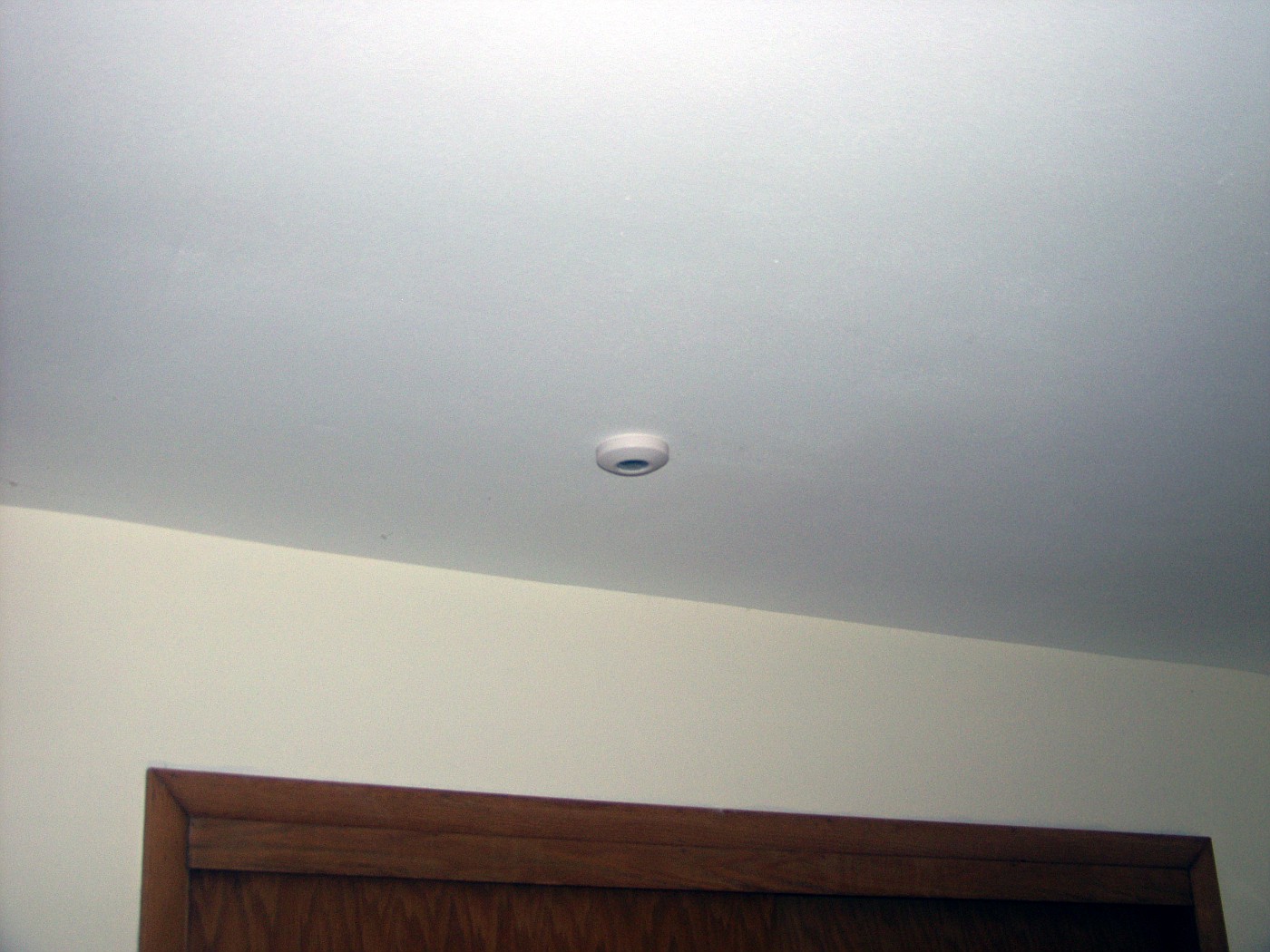

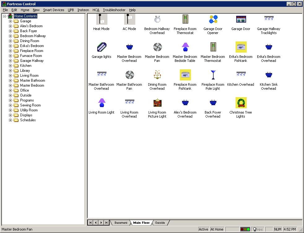

Here's a shot of Fortress Control showing the first floor layout.

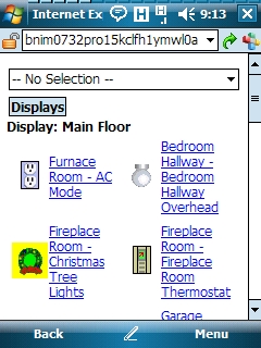

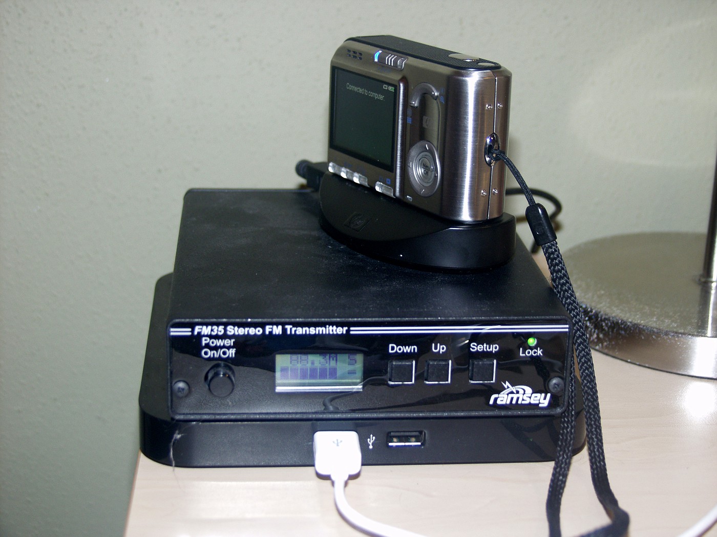

Virtualization of the iTunes server proved challenging given VMware's lack of sound card support along with its physical USB iPod and Camera connections. How did I do it? I'm using a Belkin F5L009 network USB hub ($60) and an Andrea Electronics Pure Audio USB-SA usb audio card ($44). This awsome audio gizmo is the best in the industry currently and can only be purchased here. Resist the urge to skimp on a cheaper card as I had many audio stream lockup issues when I first tried this using a $16 StarTek USB adaptor.
In short, the Belkin hub works just like the Digi device in that it acts as a network connected USB hub whose ports are remapped to the media server. The Pure Audio usb audio card provides a sound solution that works around VMware's lack of virtual sound drivers. The FM transmitter is plugged into the audio output of this gizmo.
